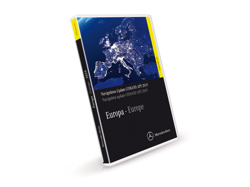

I’m coming to the conclusion that it is a 2.5, I also have Bluetooth. Does this mean there is a sd card somewhere that needs changing for a map update or is it a dealer only upgrade?
thanks
thanks
How about this:
