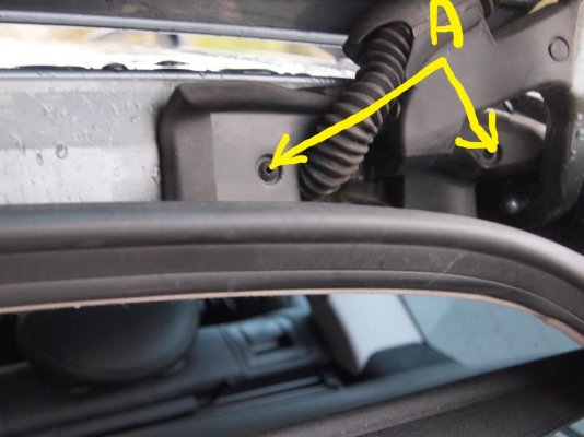

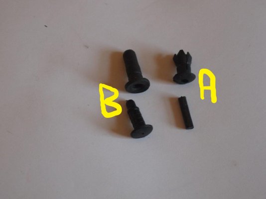

I had to unfasten and move out of the way the black plastic trim round the hinge - fastened by two plastic expansion rivets.
Also the long black plastic trim down the side of the frame - fastened by a slightly different set of plastic expansion rivets.
It's hard to see why they are different fasteners.
They appear to do exactly the same job and are interchangeable.
Unfortunately, as you press out the pin in the upper rivets, the plastic pin disappears out of sight.
Also one of the side-strip rivets broke.
Does anyone have part numbers - I can't find them on Nemigaparts.
Or does anyone have a link to an ebay source.
See photos.

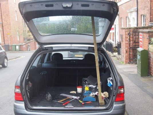

I did the job on my own.
See photo for supporting the tailgate, which is heavy.
Small adjustments of position are needed to line up the ball joints with the mountings points.
This is achieved by altering the angle of the wooden support.
To snap the ball joints onto the mounting points, I used a combination of a flat-blade screw-driver and a strong prying bar.

See post #17.
I searched ebay for these expansion rivets.
There are thousands !!!
I order and received these:
They are not exactly the same.
They are a bit shorter.
But they have completed the job.
For £2.99, they are good enough.
In the process of doing this and all fairly easy only I ordered these from SGS and they're totally not right , I think someone said they might be for the floor panel in the boot!! Not the actual tailgate as advertised. Wasted days waiting for them and now I have to pay to return them as they won't accept any responsibility. https://www.sgs-engineering.com/gsc1672-mercedes-e-class-tailgate-strut...don't order these !!!
Ordered some correct FEBI ones. In hindsight if i'd removed them first this wouldn't have happened but I wanted to fit them instantly.
So the clips do break and I found the exact ones from vehicleclips.co.uk
These Push Pin Plastic Rivet for Bumpers & Arches, 5mm Hole, Mercedes A0009903492
and these Interior Trim Panel Rivet, Mercedes-Benz A0009915940
