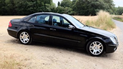

Not that it really matters too much but that wheel - Ankaa - is from the pre-facelift so it’s possible someone’s has upped the size and they did actually come on 16”.
Have a look at the datacard and it’ll tell you what it originally came with.
(Nice car btw)
