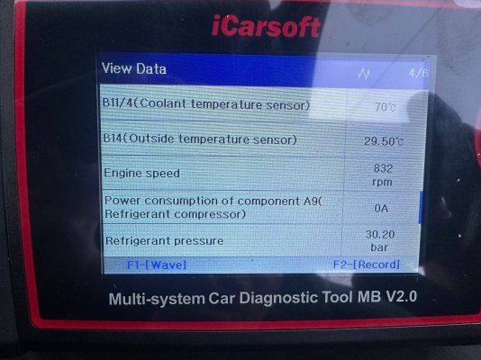

I have a 2013 W212 E250 CDI, recently the air con stopped blowing cold and the radiator fan is constantly going at full speed.
I was going to just book it in for an air con regas but decided to check for any codes or anomalies before I did.
Refrigerant pressure seems really high at 30 bar. Am I right in thinking this is likely the pressure sensor? Don’t want to regas it to have to have it done again after changing this.
I’ve owned the car for about 5 years and it’s never had an air con service in this time, but has always worked fine.
I’ve attached a pic of values from icarsoft.

Usually refrigerant pressure sensor fails and makes fan run all the time in emergency, your pressure value confirms that

Replaced air con pressure sensor and regassed air con.
Now working as expected and the fan is no longer on full speed.
Around £60 all in so not bad at all.
Thanks for the advice hopefully this might help someone else in the future.
