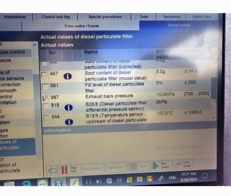

I have borrowed a Xentry diag machine, and no current or stored faults show.
It looks like someone has been in previous too, reset the values on the DPF to try and force regen, as all values for Ash/soot are zero.

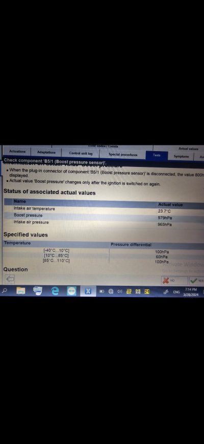

I went in to the boost sensor and carried out a test on it, at idle was ok ( i think) but when actuated, the values go red. But then this is intermittent.
Also same kind if thing with the exhaust back pressure sensor, when engine off or idle, it shows 4786hPa in red, and then once the car was up to optimal running temps, and when driving, it showed 1526hPa, which this figure was within the parameters.
