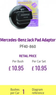

Powerflex of Powerflex bushes fame are doing Jacking pads, now so should be good. :)
Whatever you do, do not use an ice hockey puck as the car will slip off it (ask me how I know!!), use something like the powerflex one pictured above which is shaped to fit into the jacking point, just make sure it sits inside the cup of your trolley jack rather than across the top.
If you search eBay for Mercedes jack pad you will get a few options. I have one of the cheaper rubber ones that is fine with my trolley jack. Not sure how the polyurethane ones perform as they will be a bit stiffer so the fit to the jack may be a big more critical.
I ended up ordering 2x of the PF40-860 jacking pads through an official eBay distributor. The £10.95 price is excluding VAT, so just a smidge over £26 for two.
I can report they fit like a glove! Highly recommended vs. some item cut from a hockey puck on eBay for £6
