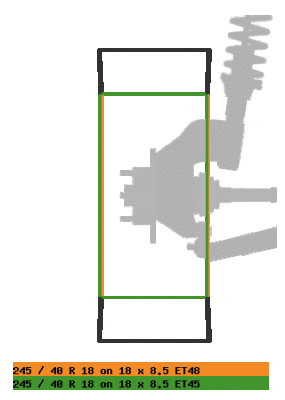

can anyone advise on what impact ET45 has over the (standard) ET48? any concerns? I already have the ET45 rims, just wondered if safer to replace them.
appreciate the answer
As you already have those fitted I don't see the reason for a concern if the tyres are not rubbing anything.
Are those genuine MB wheels?
The wheels are Diewe. Got the car with them on. Made lots of km with them.
I think my concern comes from last wheel change when I switched to the 16 for the winter. 18 came off and 16 on. But one of the 16, front left, had some issues to fit. It was installed but was not aligned. Had to insist a little to have it aligned. That’s when all started to shift in my head. Maybe these one non MB “made” something. I know it sounds stupid but that’s why I’m asking.
now I have to buy summer tires and go back to the 18s and I wanna make sure they’re suited. That’s why I asked about 45 vs 48 for the ET
See the third sticky at the beginning of the Wheels, Brakes & Tyres section; all the information, on standard fits at least, is in there.
I’ve seen the sticky and indeed it looks like small differences. My question would be if such a difference can make an impact. I’m sure I’m overthinking this but it’s more for the sake of the technical detail. I mean I see so many “performance” differences in other parts that it just makes me curious.
anyway I would say it’s safe to stick with these rims and just get my tires
