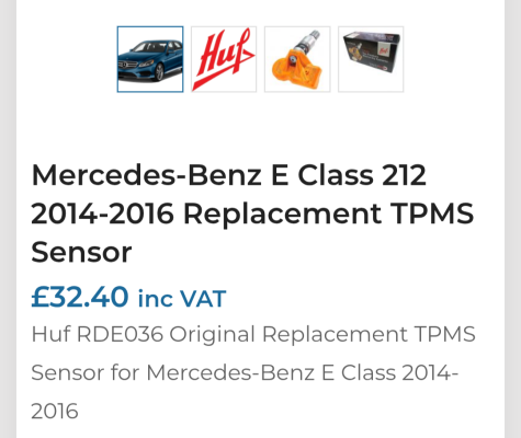

Got the wheels checked & 1 is not reading & another had very low battery so need to replace two. Do the Huf ones you linked need to be programmed?

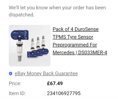

I just got these for £67 . They come pre coded , you then drive for 10 minutes and they self teach. The huf will be the same.
eBay is telling me these ones don't fit my car? 2015 E250 blue efficiency Saloon..
Yeah it did mine also mate . If there on his list they'll work. Contact him he's a genuine lad.
