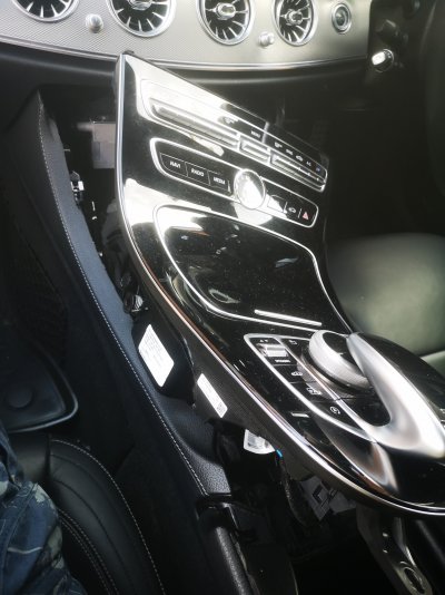

Center console creaking

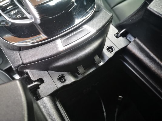

open armrest
remove these 2 rubber bumpers they just pull out
remove these 2 T20 screws
Pry out the armrest release button

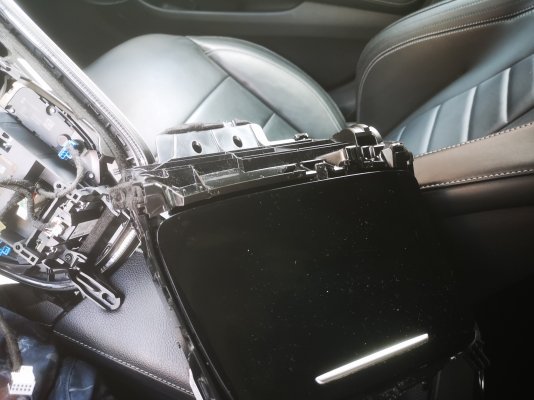

pull up un the center console
its only held in by a few clips then slide it out from the dash untill you can start disconnecting the wires from the console

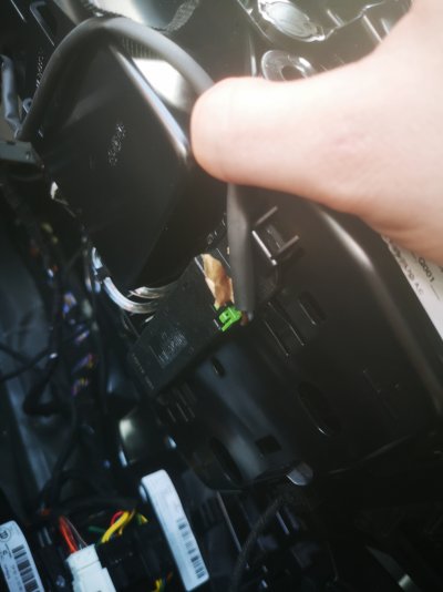

disconnect the wite cable and the black one
remove the green one from the front keyless entry receiver
disconnect the 12v/cigarette lighter
to completly remove it you also need to disconnect the connector for the hvac controls, the clock, the media controls and the abient lighting led's but to do this it isnt 100% needed

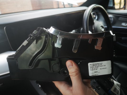

remove the 2 T20 screws holing on the cupholder/ashtray cubby
this then comes away from the trim panel
remove the silver trim by lifing these tabs
next you need to remove the lid covering the hidden part of the cubby i found it easier prying it up from the back
sorry no photo :(

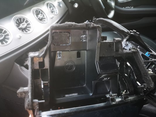

then you need to either use fabric tape to cover the edges of the cubby box or some AC-F27 antifriction coating for plastic
Part 2
just stick it anywhere 2 surfaces can touch and rub
maybe not 100% needed i then stuck tape everywhere anything may possibly rub
you can also take the HVAC and media controls aprt and try and treat them but thats more hassle than is maybe needed this should get rid of the creaking when you rest you leg on the console anyway

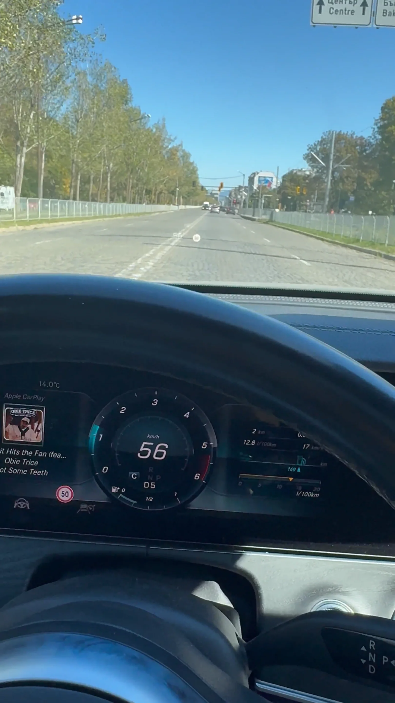

Hello!
Has someone experienced this one. It hurts my ears on bumpy roads or any bumps of that matter
