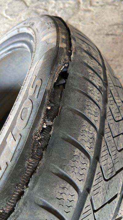

Hi Proeliator2001
did you finally find a solution? i just had had exact same problem at 45k kms
anyone has alignment specs for a e200d allterrain 2019 r19 wheels?
thanks
I ask because I had this on my previous Run Flats Goodyear on 1 tyre, wheel in motion then did a full check, and nothing was out of the ordinary.
On the German forum there is a whole thread about this exact wear, on Goodyear Run Flats, so more then likely this tyre maybe the issue.
it came with Pirelli-sottozero WINTER!!!... yeah it's strange because here we dont have such winters... actually i just bought regular pirelli zero RF because nobody sells sottozero here in chile
(as you see on image they broke, but took me home 60 kms on that conditions)
