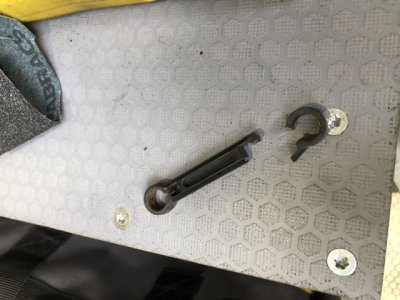

Here is my snapped linkage.
B0EEE0A3-CB1C-4F81-8965-2A881B150152.jpegWhen I asked what to expect of plastic parts on new S213 was just told “Don’t ask” ‘Nough said.
Thanks for the info/picture.
Ill take a look today to see the state of mine.
