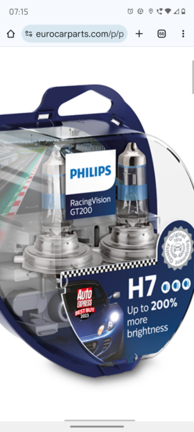

Best bulbs at the moment are Phillips race gt200. I tried night breakers , but these were better .

Having read the latest posts I was intrigued to see what was now on the market.
Call me foolish but I do trust AutoExpress reviews to a great degree.
A perfectly respectable review site 👍
