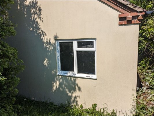

There's a window on one side of the garage that needs replacing as the frame is quite rotten in places. It's not secure so can't currently be left open. I could replace this with a unit that just had a fanlight (which could be left open if necessary) and also some trickle vents ... do you think this would be enough, or should I look at wall vents etc. as well? There are no eaves so no way to add anything there.

Replace the window with one with trickle vents and put a hit and.miss vent on the opposite wall e.g

The little window with a round vent like they had back in the day in bathrooms with the draw string to open and shut them will do the job. Or even a window that you can crack open. You just need air to circulate.

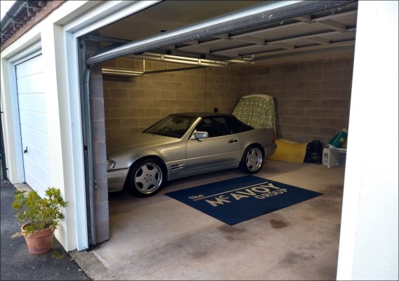

I can't see from the photo, but is the floor sealed. If not the problem will be that the unsealed concrete will just absorb any water off the cars and I can't see window vents being good enough to cope with it. My garage floor is sealed but during wet weather I have to mop out the water that just sits on top of the floor, surprising how much water the cars deposit on the floors when put in wet.
It looks like bare concrete but there's a big barrel of sealant there from when we moved in so I assume it was treated with that previously. There are puddles underneath Mrs BTB's car when she puts it away wet. Wouldn't hurt to treat it again sometime this summer.

As a small update, I found that the doors actually had hidden downward-facing vents at the bottom, just above the rubber sealing strip. I've also found that by cracking the doors slightly open the top section opens a significant distance - not secure as the doors are unlocked, but quite weatherproof. Will probably add a dehumidifier for the winter - thanks for all the advice & suggestions!
