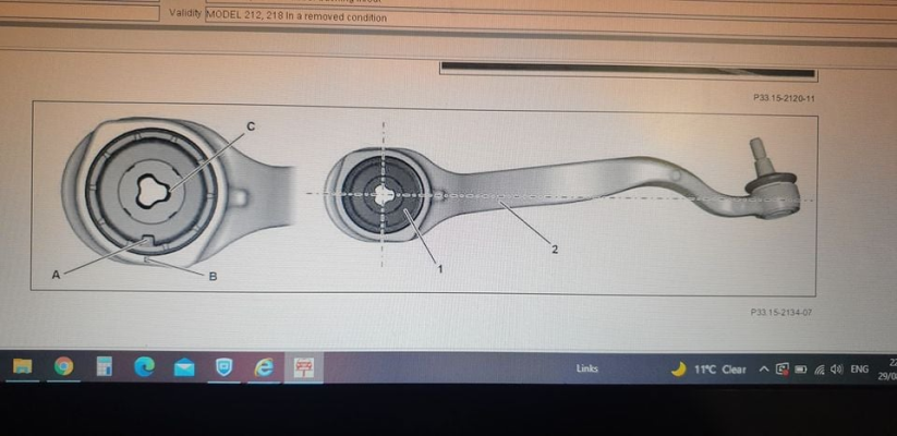

hi guys! just bringing this post back to life - i pressed in new bushes into my old arm according to the mercedes workshop manual
ive done it for a few customers recently as people thought it cannot be done-most mechanics thought you need a massive industrial press - i am based in huddersfield HD2 if anyone wants this doing contact me. i will do it and post arms back to you for £20 providing customer pays for postage =)
i use a 20tonne press and works a treat!

Did you manage to press the ball joints as well?
