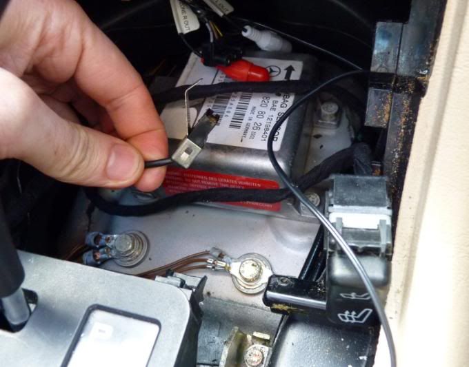

What is this wire for in my w140?
kps70
Jan 1, 2010
72
Cheltenham
MB S500 W140, VW411LE, VWPassatTDi, VWGolfMkI, VWType2
Hi - it's just loose behind the wooden trim in my W140.
Looks important
think the ashtray electrics are on one connector.
Mmmmm...
ttt
Could it be something to do with the airbag sensor?
I guess not as I would probably get a warning light.
Someone must have seen this wire before?!
What is in the black plastic housing?
Looks like either a female spade connector or a mini capless bulb holder and that metal tang looks like an earth to the lighter body so I go along with the cigarette lighter illumination.
Nope, I have checked the back of the ashtray and there is only one 3 pin connector so this wire must be for something else. Somebody must know!!! I guess at some point it may have had a different ashtray with a different connector but v. unlikely. It's bugging me now.
It may not be for anything. Maybe an option your car does nor have.
Nope - it is for something. I checked the voltage. Weirdly, it is around 0.4v with no ignition and about 0.9v with ignition on. I'm going to get to the bottom of this one with someone's help!!
