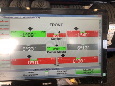

I have recently hit a kerb in my car which buckled the wheel and caused some damage to plastics. I have had the buckled wheel straightened however I’ve taken my car to kwik fit and they have shown me a picture of the wheel alignement (see attached). After speaking with a family friend who owns a garage he tells me I can only have my wheels aligned at Mercedes themselves as Mercedes do not release the information? Not sure how correct this is hopefully someone can help. Would prefer to take it somewhere else other than Mercedes if possible as Mercedes will most likely be extortionate. 2E2558A1-E83F-4A02-8017-10B249549D89.jpeg2E2558A1-E83F-4A02-8017-10B249549D89.jpeg
I don't believe that is correct. There are many tyre shops with equipment that is pre-programmed with all MB model specs..
Obviously MB can do it but in some cases the dealership will farm out the work.
Have a search for tyre shops with Hunter alignment equipment.
Go and see Paul at Drury Lane Services in Oldham. He has the Hunter Hawk Eye set up and really knows his stuff on chassis alignment and steering geometry.
The information from your garage owning friend is incorrect. There are of course different skill and experience levels from specialists like Wheels in Motion and others, I took my car to a local Kwik fit place with a view to 'get it done properly' elsewhere at a later date.
No need , they had the latest 4 wheel alignment equipment and the guy doing the work spent a long time searching his database making sure he had selected the correct programme for my car as he had never seen a C55 AMG before.
My independent MB specialist does not do wheel alignment , he sends/takes any cars that need doing to a local outfit he trusts near his premises, it's not and MB workshop.
My local MB dealer don't do wheel alignment.
Fortunately I have a specialist wheel and tyre shop near me with the latest hunter equipment.

In answer to the original poster, Kwik Fit can do alignment for Mercedes cars.
