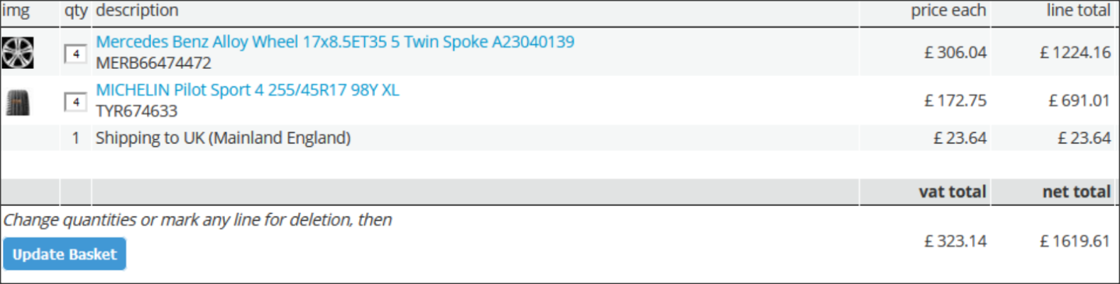

This is what I went for for my R230:-
Prices will undoubtedly risen since I purchased these.
