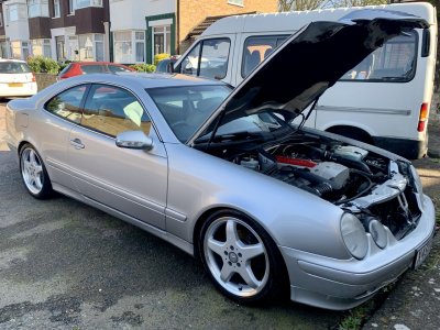

So any one had any dealings with wheel spacers been Overly cleaning the motor this week as expected and I think the rear wheels need to come out 15mm so I’m gonna get some spacers it has 18 AMG wheels on it just wondered if anyone had this set up it is on a set Jim coil overs and back is as low as it will go

I have 2cm on the rears and 1 cm on the fronts - H&R Hub Centric.
Dont buy cheapo versions and make sure they come with the correct length bolts.
Check my video here:
19s (285 on the rears)
