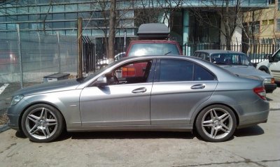

I am trying to decide if my car is just a bit too low, it has H&R super sport springs, originally that was fine but i recently added Koni Sport Dampers and Original Mercedes 5mm rear spring pads.
I cant help feeling its a little bit too low now, the front seems fine but the rear just looks a bit off to me.
I don't have any rubbing issues and handling is great, although large speed humps catch it out a bit, got to hit them at a angle.
p.s. Excuse my dirty wheels and the carbon mirror covers are going very soon i really don't like them, just my originals had a accident, they're a bit chavvy...
The rake does look wrong. Historically the rear should be +10mm compared to the front. If the rear is down like it is the CG and what's called the polar centre moment of inertia is retarded and although the car may feel like it's handling well it could be better.
Thanks for the reply, I am going to replace the rear spring pads to lift it a little.
I have measured from the road to the top of the arch the fronts are 620mm and rears 605mm, while i am sure that's not the correct way to do it, it gives me an idea of what i am working with.
I can replace the rear pads, currently 5mm with 20mm pads bringing the rear up to 625mm, hopefully that gets me where i want to be.
I have found when pushing on if the surface is uneven or poor it can skip a little on the rear, i guess this is in line with your assessment !?

I have fit the larger pads today, i may have not articulated it correctly previously, the larger pads are what was in the car before the springs and dampers had been changed, i fit the smaller pads myself under advice.
After putting the originals back in i am approximately 615mm in each corner from the floor to top of the arch and it looks much better.
