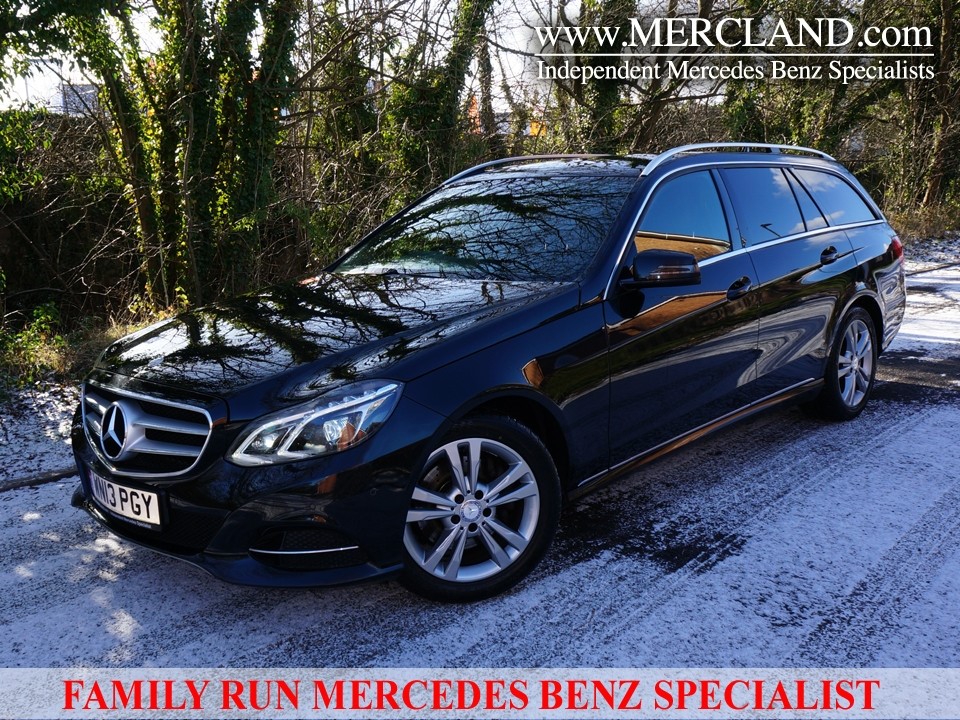

What about something like this
I have the E250 and love it, gentle rumble of the engine is nice, fuel is also very good, plenty quick enough.
Looks great that, I was thinking if it’s got the history and backgroundmileage doesn’t matter so much.
Looks like it could be the E250 estate then reading this. I think the extra mpg would really help and from what you guys said it’s a good all rounder. Thanks for the info guys I appreciate it.
