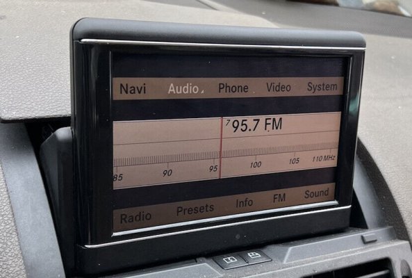

I recently returned a 2010 C Series shortly after buying it for a number of reasons. It had the satnav / stereo screen that flipped up automatically when the stereo was switched on (see picture 1 below).

There are two variants of the information system for the W204, each comes with its own screen.
The infotainment unit with the smaller screen is Audio20, which is very basic.
The infotainment system with the bigger screen is COMAND NTG4, which is a better system and also includes navigation on internal HDD (but obviously this being a 2010 car, the infotainment system will be obsolete in today's terms, especially give that it was originally designed in 2006).
If your budget stretches to the 2011 facelift model, then you'll get a car with a nicer dash, and either Audio20 with the optional Becker Map Pilot navigation processor, or COMAND NTG4.5 which is a more current infotainment system than the older NTG4 unit that comes with the pre-facelift model.
With regard upgrades, upgrading Audio20 to COMAND NTG4 is doable but it's ££££.
