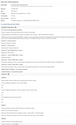

My car is out of 'sync' with mercedes system as the original owner skipped the second service (because they got the gearbox service done elsewhere), but the ESS says this for my car (I don't have adblue nor is the gearbox covered for a service)... see no mention of the diff in the upcoming service (milage will probably be around 146k then)

I've just looked at the diff oil replacement on WIS today. Pretty simple. Clean the diff around the drain and fill plugs. Undo fill plug. Undo drain plug.
Drain.
Refit drain plug.
Fill until oil flows out of the fill plug.
There was potential oil spec change over around the age of our cars, with warning not to mix oil types. I'd suggest oil from Merc to be certain.
Absolute dry quantity is apparently 1.2 litres. Might get away with 1L bottle. Could re-use some old oil in a pinch if a tiny bit short.
Car must be perfectly level.
50NM torque on both plugs.
Use a small smear of thread sealant when refitting the bolts.
WIS also recommends new plugs.
Does it need to be level, with access from a pit/lift? Or perhaps 4 jack stands, hehe. If it's that simple, I'd hope an indie would do it for £50 or so. Does the WIS mention service intervals?
