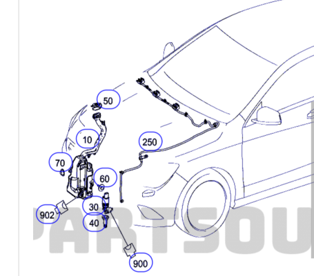

Just something I stumbled across when I had similar issues with the wife's ford Kuga. The fizzing action agitates the crap on the filter , apparently 😁. Is the washer bottle motor not just behind an arch liner ?? Also wondering if you could possibly blow compressed air down the pipes to free up any crap ?? Think this is yours below .
View attachment 172091View attachment 172093
Just seen this today, apologies. Yeah that was the set up of mine, behind the arch lining, such a nightmare!
