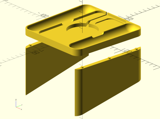

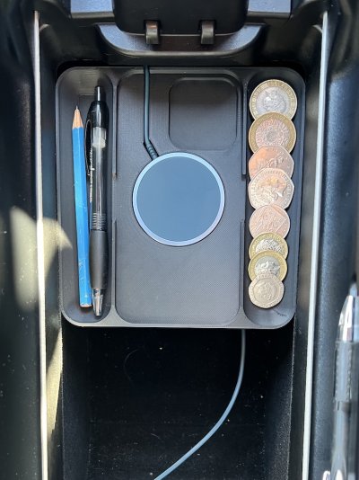

I was looking for a way to mount my phone with a wireless charging cradle. Having recently fitted a CarPlay adapter to the car I don't actually need the phone to be visible/accessible on the dashboard, so I figured the centre console cubby is a good place for it - only the plastic cubby lid over the top of it and with a good 'view' out of the sun roof and the windscreen, meaning that satellite reception for the satnav should be fine. I designed and 3D printed a tray to sit inside the centre console cubby, suspended in a 'mezzanine' fashion. The recess for the phone is sized to suit the dimensions of my iPhone inside a silicone rubber case, and the magnetic wireless puck is glued in with hot melt glue.
The space was a bit awkward to fit - the width of the cubby tapers from front to back, and the floor of the cubby slopes quite a lot. But the result is a nice snug fit, and it leaves the space underneath the tray for the usual centre console junk. The legs are located by pegs and superglued on - the joint doesn't have to be strong because the tray is wedged in place and can't move laterally.

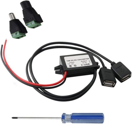

I just need to find a way to fit a USB socket inside the cubby now. I have a 12V-to-twin-USB adapter, so I just need to find a convenient way to wire it in. I'm not keen on Scotchlocks, and I'd prefer to take a feed directly from a fuse box, e.g. with a piggy-back fuse. I was expecting to find a fuse box in one end or the other of the dashboard, but I only have one in the engine bay and one in the boot, and neither lends itself to conveniently running a cable to the central cubby. In the meantime I just plug the charging puck into an adapter in one of the cigarette sockets.

Yes, the two cigarette lighter sockets are both options, because they'll have a far higher current rating than is typically drawn by USB devices, which is all I ever use the sockets for. But I have an aversion to cutting the original wiring, even if using the excellent Wago connectors. Now if I could find the same plug (and a matching socket) that is used on the cigarette lighter socket, I'd be happy to make a y-connector to tap into that circuit. In the old days it was easy - the cigarette lighter sockets typically had spade connectors on the back, but things are a lot more sophisticated these days :-)
Idea!
Whilst I don't like cutting/splicing into original vehicle wiring, I'm less bothered about splicing into the wiring of things I've added. The CarPlay adapter uses a wiring harness to get its power from the COMAND head unit's supply. I'll check the various ratings, but maybe that supply can handle another amp or so to provide the 5V 3A output for those two USB sockets. That's an option if I give up looking for a direct feed from a fuse box.
