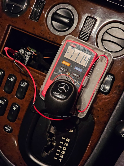

Long story short, the van had a Kenwood stereo in it. I've done nothing, other than unplug the stereo, and plug it back in again. Now the stereo shows 'miswire' and powers off.
I connected up a new stereo system, and the moment I plugged in the speaker block on the ISO connectors (No power ISO plug in yet!) the right front speaker in the van started emitting a buzz/whine and no sound would be produced.
I have probed the speaker connector, and am getting around 11 to 11.5v DC across the positive and negative Front right speaker connector!!
I have already tracked back and undone the entire insulation job, removed all the trims in the back, and double checked my connections to the rear speakers- all is perfect as it should have been - nothing is out of place.
I'm baffled - how can DC power be getting to the front right speaker? why only 11.5 volts? Where do I start!
Hopefully someone out here has an idea.
