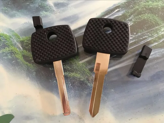

Now, after locking the car with the remote/key, and, if you were then to lose your remote fob, then you would need a spare remote fob OR a spare valet key with a transponder chip inside it in order to open and start the car, like the one pictured below, the little drawer in the key head is where the transponder chip is located.
10pcs-lot-for-blank-Transponder-Key-Shell-case-for-Mercedes-Benz-with-HU64-HU72-blade.jpg_640x640.jpg
So, having lost your remoter fob/key, you would unlock the car with the valet key blade, as soon as you open he drivers door, the alarm will go off, if you then put the valet key into the ignition then the alarm will be disabled (by the transponder chip in the key head) and the car will start.
Because you have lost your remote fob/key then the only way to lock the car is manually, with the valet key, in the absence of the lost remote fob/key, the car alarm can no longer be armed.
A valet key, like in above picture above, is the best and cheapest solution, after all, you may never have the need fore a spare key/remote fob.

Above is correct, the new valet key i bought is thus, unlock drivers door with key, open door, all other doors open, alarm will sound (mine does not as i know its siren has been deactivated) put key in ignition, start car, alarm goes off, drive car as normal.
To lock car, remove key from ignition, lock all other doors with central locking switch on consul, get out of car and lock drivers door with key.
In a way, its just like the old days, meaning 60's and 70's before central locking was added to cars.
