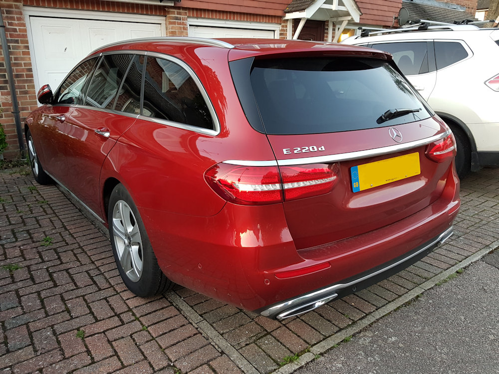

So after a few months some of the magic has worn off!
The active lane keeping assist is more like a suicide device as the car seems to have no idea where the lane is and often drags me on to the grass verge / into the hedge or off to the opposing lane even though I was central in my lane. So that feature is now switched off.
The drive pilot has similar issues and if I do let go of the steering wheel it wanders from side to side like a drunkard.
The remote parking feature has pretty much stopped working now and hardly ever connects with my phone (Samsung s8). I need to try it with some other phones to be sure if the phone or the car but the phone works fine with every other Bluetooth device, including Comand.
I have not bothered to renew the data plan after the free trial as the 3G connection is so slow and has no real benefits.
I seem to get flashed quite often so the multi-beam headlamps are not perfect but they are fascinating.
Also missing a heated steering wheel that I have on the previous 4 cars. I can't understand why the option is not available in the UK especially as it seems to be available in other right-hand drive markets.
Everything else is good. I like that I've averaged 51.3 mpg for the last ~4000 miles. My best is 67 mpg on one 25 mile journey. Getting a massage is also very nice as that works very well.

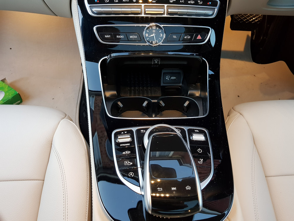

I love it. But I find it a little like Microsoft Windows in that there is more than one way to get to the same menu or item. It's easy when you know how and you just need to find the one that works best for you. That said, half the time I just use the voice commands as once you've mastered that it's even easier.
One thing I can't get away with is the touch pad on the centre console (love the ones on the steering wheel) it just makes me feel really cack handed. Maybe I'd get on with it better if the car was LHD or I was left handed but as it is it's pretty defunct.
