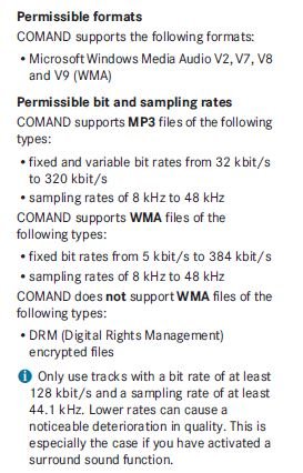

A facelift car? The manual should list supported audio formats.
Yes, 2011.
The audio works fine, it's the video that's not. I'm trying to establish whether it's even possible to play movies from a USB first, and then can work out how.
The manual isn't conclusive.
Sorry, don't know why I thought the issue was about audio formats. I never tried video from memory card and I only had NTG3 but perhaps the data would need to follow the video DVD format. Have you tried to copy a complete DVD to a USB stick?
