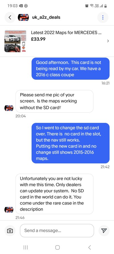

Hi all. We have just picked up our car, 1st thing was to update the maps so purchased sd card for the car, (same seller as for my GLC)
I went to swap the cards only to find no card in the slot BUT the maps are working showing 2015-2016 maps. The new card makes no difference.
Is my sd card slot the problem?

Did the seller confirm map comparability with your new Comand unit and even your VIN?
Does the unit need an associated firmware update?
Cheers guys, I will look into it at the weekend
That's BS.... the simple answer is that your car (most likely) has COMAND with built-in navigation, and not Audio20 with navigation on SD-Card. It isn't rare at all.... and in fact it's good news, because COMAND is a better system than Audio20.

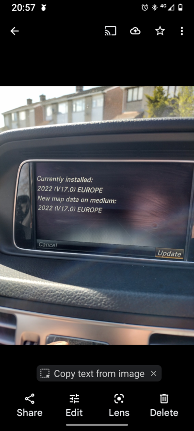

Give that lad on eBay your vin number and a picture of your satnav screen and buttons , he'll know which update you need , my 2016 e350 registered in 2017 was a facelift version , he knew exactly which one I needed , I bought it ,installed it , and it works 100% .I went from 2017 to 2022 in an hour .

That's mine in the picture when finished. Bought it a few weeks ago.
