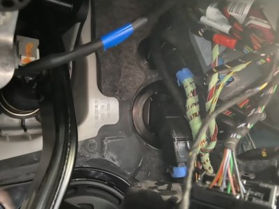

On an earlier suggestion which prompt me to pull out the carpet and check all the seals and plugs. annoyingly they were all solid and firmly in place which leads me to believe it’s something defiantly mechanical 😟 pics attached if they help anyone

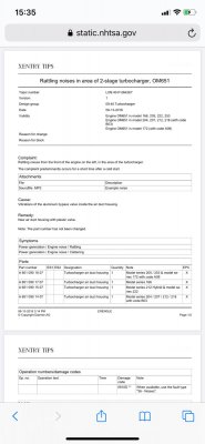

Update, issue identified - had the car diagnosed with via STAR - no codes or issues found.
The noise in question is generated by the bypass valve in the stage2 turbo housing. The metal valve rattles against the aluminum housing and vibrates when under boost causing the grindy metallic noise, it’s only noticeable really to the driver.
mercedes fix to this is to replace the turbo housing with new one which has a plastic valve. It’s prevalent on the om651 engine and rectified in the new builds.
New housing costs £500+ plus Labour and vat makes it £1000 approx job. (No thanks!)
it’s not critical to the cars running, just an annoyance and common on the gen1 w205 models and previous w204. (attached) is a user case example with part numbers
