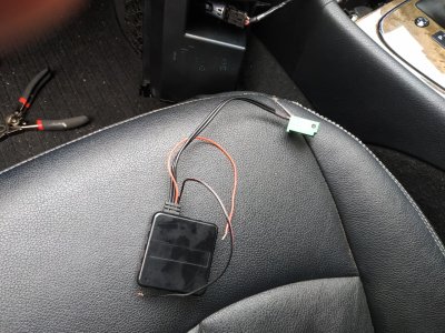

Here it is:

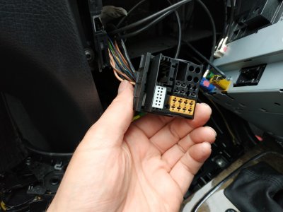

Find the large harness connector on the right side of the unit and unplug it. On my car there is a connector in the harness I had to remove that ran to the aux-in port. Pic below shows that removed. IMG_20200826_111601.jpg
Then plug the BT unit into the harness, and reconnect it to the COMAND unit. There is plenty of space behind/below the unit to hide the BT module, just shove it in there. I wired switched 12v from the cigar lighter and put everything back together. Switch on ignition, fire up your phone and find the new bluetooth device available to pair to, switch your unit to aux and enjoy the sounds!
