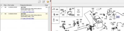

Since the 2010 does not have stop/start, it only has the main battery and a very small "selector lever backup battery". It is under the dash as mentioned already. On a LHD car it is at the left side of the dash, pretty difficult to see unless you know the location.

Thanks for the diagram..
Mercedes Benz recon there's no auxiliary battery, as I don't have stop start too...
