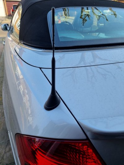

Also fitted a rear cam at the same time, all cables ran together no interference. Access to the rear quarter panel was via the boot, not easy being a convertible but I didn't have a lot of options on where the aerial could be fitted.20250324_144203.jpg
Also fitted a rear cam at the same time, all cables ran together no interference. Access to the rear quarter panel was via the boot, not easy being a convertible but I didn't have a lot of options on where the aerial could be fitted.View attachment 169330
that looks the business, Unfortunately I think the curve on the C180 is too severe so I think boot lid is my way forward. The thought occured to me that the camera cables are only powered when in reverse so id say acceptable risk there on interference.
