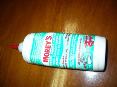

Moreys is NOT snake oil, I can deal to HSV's and Harleys in a 1500 cc diesel Toyota Starlet on it - well, twice the recommended dose. :):) You don't NEED it but if you use it it WILL give you quite a difference in power and smoothness.
