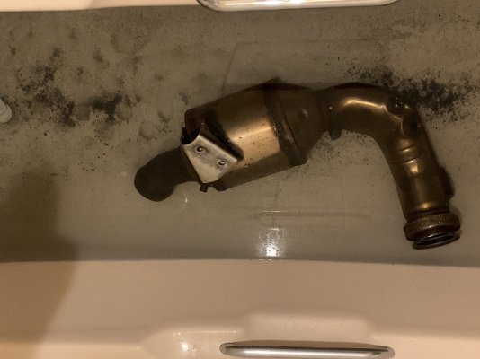

After the soak, sprayed out as much as I could with the pressure washer (until I was told off by the wife, it was 9pm) then sloshed in warm water in the bath a few times
After this I poured a kettle of boiling water through each way (back to front first, make sure it’s held with an oven glove or something as it holds the heat like nothing else!) then left it over night in the airing cupboard to dry out.

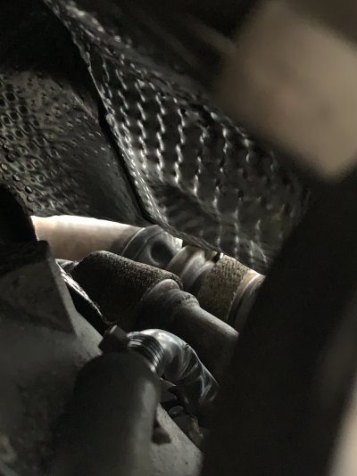

Then was the re-fit!. I fitted the bottom mounts loosely to begin with to allow some movement
The very worst bit as I expected was next, that was getting the collar on between the CAT and the DPF, this alone took about an hour! Luck I have thin arms as I had to reach up and locate it from the bottom (2nd pic)

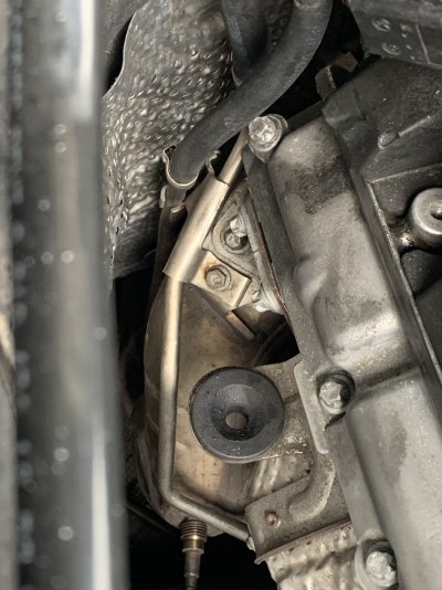

Make sure the DPF pressure pipes are positioned properly and secured from the top first otherwise you will have to undo the bottom again, I made this mistake after refitting the under trays!

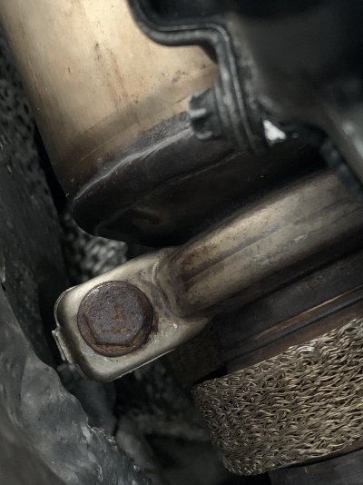

Exhaust clamp (recently replaced on prior removal when I did engine mounts so thankfully easy)

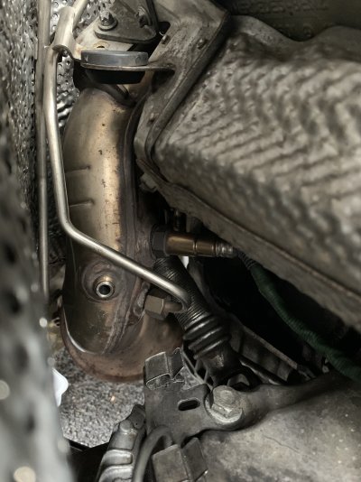

The bottom pressure sensor connector
Then refit everything top end!
