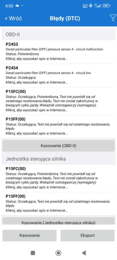

Looks like pressure sensor. I watched some YouTube videos and should be able to do it myself

The pressure sensor was the first to go on ours - it failed at 64k miles. However it put it into limp mode, which isn't what you're getting??
So I replaced sensor. And have few shorts drives around the block. No check engine management light or limp mode. Hopefully this problem is sorted. It's very easy to replace sensor ... however taking sensor off the rubber hoses was a nightmare. I must of spent 25 minutes alone trying to get it off. Other than that it was easy and I learned how to replace air filters 😀 Thank you all
