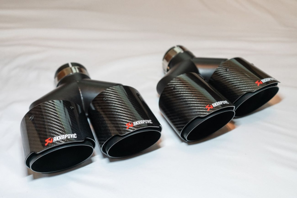

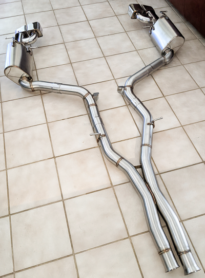

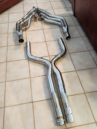

.......and 3 inch pipes with only one straight thru silencer per bank and 4 x 4 inch carbon tail pipes..Custom Race Camshafts, SLS Lifters, Adjuster Plates.........sounds like Satans own car! Stolen from a site over the pond I use....

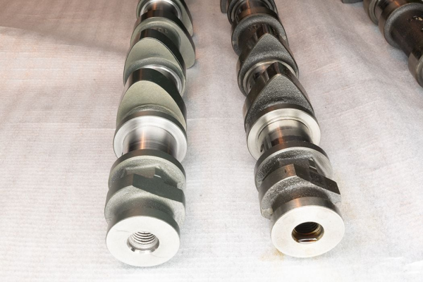

Side comparison between custom spec cams and factory camshafts.........yikes!

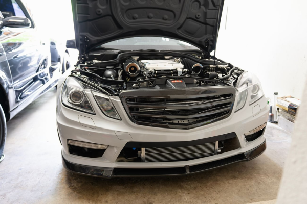

That's what everyone says but when you're charge cooled then in the real world it doesn't really matter.
Nope. Power lost compressing hotter air. Power lost due to lower air density (charge cooling cannot compensate). Two hits. The first won't even be understood by them I'd wager.
Sort of correct....which is why he later changed it for this......but then discovered that when moving above about thirty the intake temps where the pretty much same. It only gets hot under the bonnet when not moving.....otherwise there is loads of cool air being forced in there. Its a bit a myth that under bonnet intakes affect power........ once moving.
Where do you think the heat from the radiator and intercooler are going?
Being easily blown away by the 60 mph gale blowing though the grille.... !
The supercharger makes the air hot whether it comes in cold or hot. The charge cooler then nets you a similar end result on the air going into the engine, as evidenced on the move. Doesn't really matter when you're standing still as you're not trying to make 700hp.
Yes Agreed 100%. I have tested a few cars during tuning, by placing air temp probes in the engine bay, or inside cone filters that are in the engine bay. Once above 20mph, temperatures at the air filter inlet equalled ambient air temperature. Some cars/platforms have restrictions in the OEM air inlet system (packaging reasons, NVH reasons etc) that mean a "hot air" intake is a worth some power at the higher RPMS. In my experience, the difference in the real world is negligable. Heat soak becomes a bigger issue at low speeds/extended idling though, only really noticed at the drag strip when staging!
