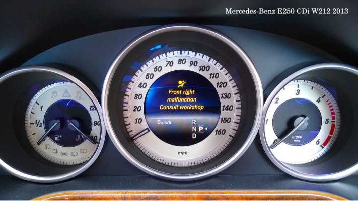

So here it is:
This afternoon, completely out of the blue, the above "pearl" pops into my dashboard odometer.
I have dug around for info and it appears it could be the wiring, the seatbelt socket, the driver's seat wiring loom under the seat, the fuse, electrical connectors, and whatever else, including the airbag, presumably. Mercedes has a problem with airbag technology. On my previous C-Class Estate (2013), there was a recall for the passenger side airbag, now this.
Thinking of taking it to an MB specialist around Durham, if there is one capable of dealing with this.
I haven't heard from the garage yet, and tomorrow is Monday Bank Holiday, so I am not sure if the garage is open.
I will publish here on the progress, it may be useful to other MB owners in the future.
Regards

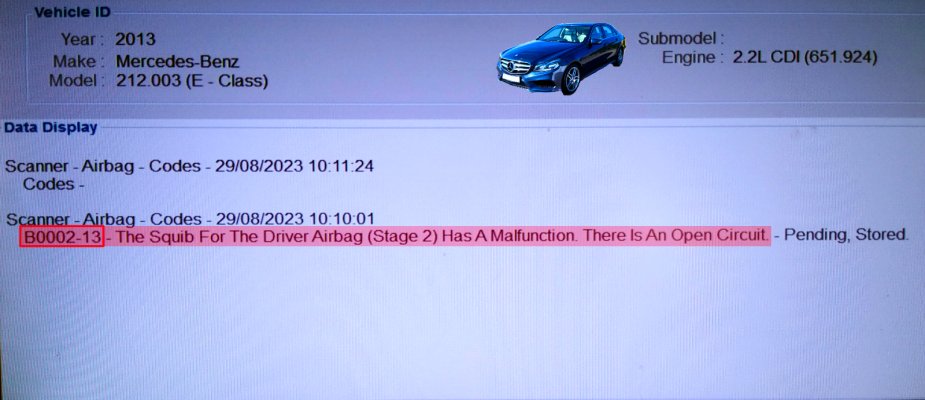

So, with the above in mind, I went to my village's local independent garage,
Browns Auto Services. The owner who I know well, Gareth, is on holiday, but yes they do have the modern Diagnostic tool required to read Mercedes-Benz codes. How long would that take?... Oh, inside 5 minutes, I can do it right now for you, Sir and it will be £45.00 inc. VAT.
My verdict: 5 ⭐ ⭐⭐⭐⭐ out of 5.
DIAGNOSTIC:
The "Squib" is actually the low-resistance wire that is coated with explosive matter and carries the function of detonating the explosive charge which in turn ultimately deploys the airbag.
This is the reason why an airbag warning must always be decoded immediately, in my opinion. But I must stress I know just the basics and I am not anywhere nearly as car technology savvy as many other club members here. But being an MB Club member to me means sharing with my fellow MB owners information they might find useful, especially if it carries a safety risk. I have been advised not to drive the vehicle on more than just the odd local, definitely not on motorways or main roads. The potential for the steering wheel airbag to deploy accidentally and cause an accident is a possible outcome, even if remote, it is not worth risking.
I hope this information proves useful.
Kind regards​

It doesn't, it would appear. This “squib” thing is a funny name for what is commonly known as Steering Clock Spring or also Airbag Spiral Cable.
My car was built after 2011 and before 2017 (Manufacturing Date/Year 2013). It should be in scope for the Recall issued by Mercedes-Benz, precisely to replace this part, as it has a manufacturing fault.
In the UK alone, there are 400,000 MB vehicles affected by this issue. This includes A-Class, B-Class, C-Class, E-Class and, CLA, GLA and GLC models built between November 2011 and July 2017. It is a major manufacturing fault.
But Mercedes-Benz of Sunderland did not tell me that on the phone when they quoted me One hour £174.00 + VAT just to run a diagnostic worth 5 minutes. :) It could be an oversight, or it could be plainly dishonest.​
