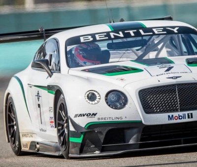

Ermmmmm, can you get me one of those body kits (without the wing) at a “cost effective price” :cool::D

So long as you can provide your car in the condition shown here so we can fit it, then I'll see what I can do!IMG_0778.jpg
It's a bit more than a body kit....but the lights and the door handles are standard...errr ...and that's about ito_O
Here, the composite roof panel and rear quarters and being bonded to the roll cage....sorry bodyshell...
What a great pic. Gives an insight into just how much work goes into "prepping" one of these cars. Some people.......... think you just drive them at speed, through the nearest Halfords then
wait and see, what bits have stuck to the bodywork
You probably want one of those interior mirrors too!
Our Northern Irish driver Stephan Kane said " Aye cun see nothin' in ma merse" so we gave him this 'panavision' one to see through all the roll hoop tubes. He rarely gets overtaken now.....
Yes, that was the result of almost 3 months solid work of two of the best guys in the business at M-Sport in Cumbria.
It was another 2 months before the prototype had a nice big turbo V8 under the bonnet, 400mm further back and 200mm lower than the production car:cool:
