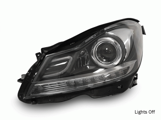

New here. I had a little bump not so long back and caused a little damage to the bumper & also the left indicator has stopped working but no damage to the cornering light, headlight, DRL etc all working just not the indicator which is really bugging me.
I have the headlight style attached and it looks to be like 10 small leds is that right? Or is it one bulb that shines on them all? Any help would be appreciated, I’m going to check fuses also if anyone knows which ones, I believe it may be 2 & 13?
Thanks !!
Sooooooooo … what I’m asking is, do I need to to replace 1 bulb or several bulbs (if that’s possible)? Can I fix my indicator?
If it's LEDs they are probably integrated and can't be replaced and it would be new headlight time. Take it to a Merc specialist for a fault scan and they might be able to give you a more definitive answer.
From the image/GIF linked it looks like LEDs.
Indicators are LED in these units and as far as I know are SMD, not replaceable 'bulbs'.
From memory, only the HID dip/main and cornering lamp are 'traditional' bulbs.
