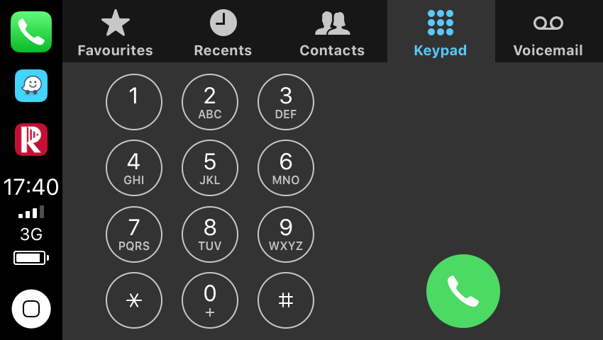

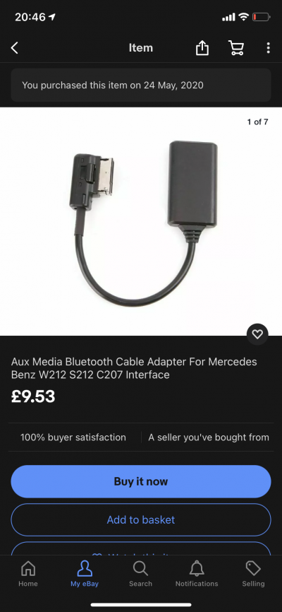

This works perfectly in my w212
Ah right. Where does the slim silver end plug in to then?
