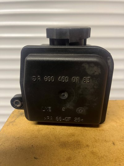

Many older MB cars have this (or similar) in the power steering system , this being a 2006 C class . It's not just an expansion tank it is a throw away service item with an inbuilt filter . It can be bought for around £25 and is held in by one bolt , one pipe clamp and a outlet pipe clip , basically an easy service item that is often overlooked .

I have a Febi PAS fluid tank ready to fit to my CLK. I read somewhere about the filter in the tank. I wonder if the Febi one has a filter ? If not there is no point in me changing it. The fluid has been changed, I have a spare tin to do another change.
Not sure , but it sure is a service item , cheap , one bolt , 2 pipe clips (the feed pipe is quick release).
If it's Febi (like my replacement one ) it's a direct 'copy' of the MB one , Febi might even make it for them . Either way the one you see cut open in my first post is a Genuine MB one off my car.
For anyone else doing this, note that there is a rubber washer inside the larger (feed) pipe on the header tank. My Febi unit came without a new one, and I didn't notice until the new tank started leaking. Also, the clip on the small diameter pipe was single use; I needed a 16mm Jubilee clip.

Yes ⬆️⬆️⬆️ I was lucky enough to spot it before assembly , bit cheap/dumb Febi not supplying with a new rubber seal, I just used the old one, it's not under pressure and is working just fine.
On my old W124 convertible, the filter is removable. It's definitely worth doing. It's really useful to know I can do the same in my w208 clk. Thanks! 20230523_164132.jpg
