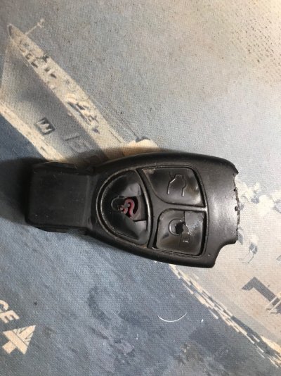

I cannot recommend this young man highly enough, my one and only key for my CLK W209 was in a damaged state and very frail as a result.
In just an hour I had a new key & fob married to the car with the original fob refurbished and working perfectly!
Just a shade over £200 for peace of mind.
Thank you Matt. (@ ReplacementMercedeskeys.co.uk)
