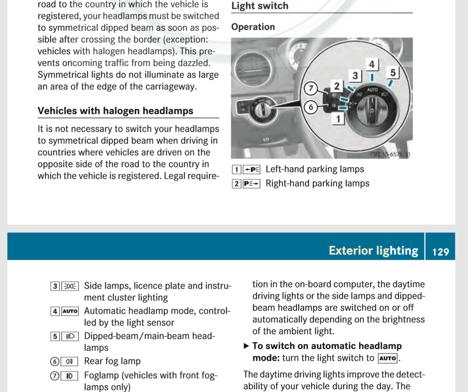

It's different on the W204 facelift....
Thre's no 'Off':
