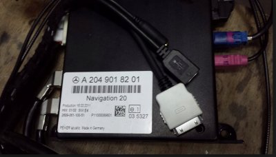

I have standard Audio 20 in my w207 pre facelift with bluetooth but without BT audio streaming,
I want to add the Navigation 20 module
The question is does it add BT audio streaming?- Does anyone have this Navigation 20 module installed?
Does it give the BT audio streaming?
The very first Navigation-20 systems did yes but this was quickly withdrawn.
How can I verify that? The Navigation 20 came only with this number A204 901 82 01
No it didnt.
The early ones were called UMI and were problematic. They were subsequently given a firmware update to bring them up to Navigation-20 spec but so many of them had main controller failures that the product was dropped. there were a number of different part numbers. some worked with the W212/w207, some didnt. Connectors and looms changed throughout the life cycle too!
So the unit with this number A204 901 82 01 can or cannot enable Bluettooth audio streaming? its a lottery?
