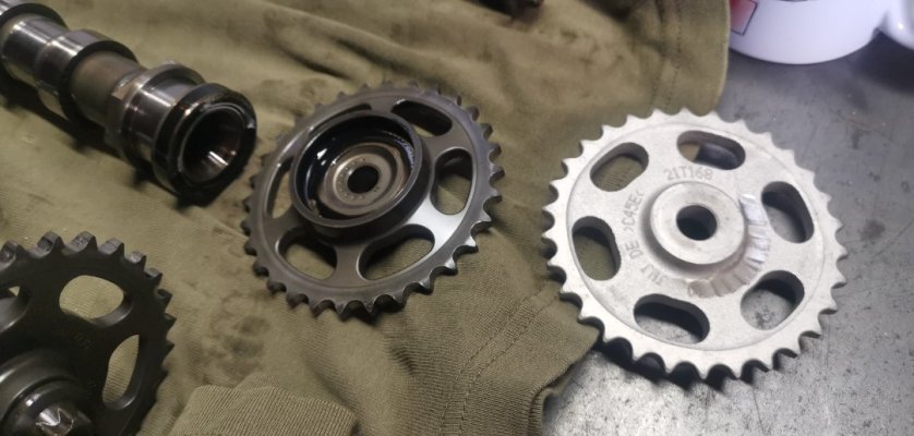

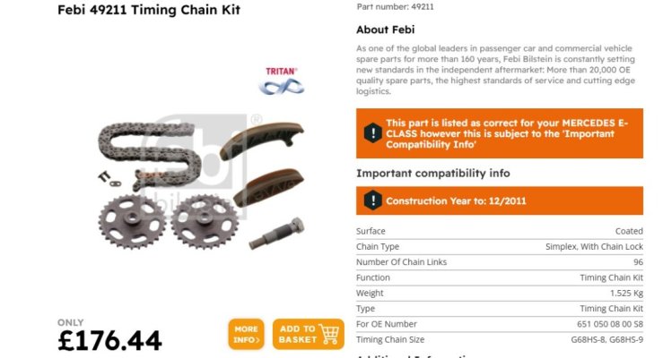

I ordered the kit that says it fits my car, got it today and the camshaft gears is nowhere the same!
Their mistake? I ordered this kit here - https://www.autodoc.co.uk/febi-bilstein/19921102#timing-chain-kit
It clearly says construction year to 12/2011
what are these cam gears they sent of??? anyone knows? photo attached

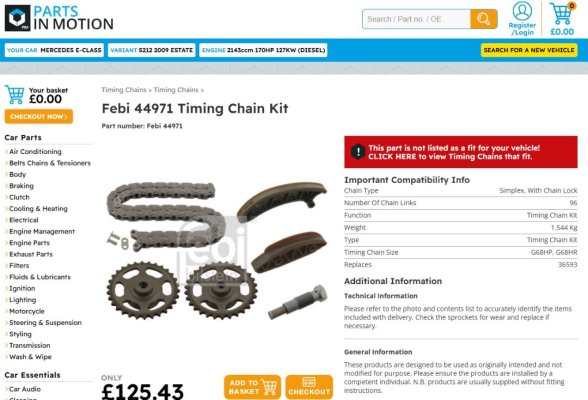

and now searching about on the internet, hoping to find some in the UK, I came across partsinmotion website, put my reg plate on it and booomm - one of their listings show a photo of a kit with the timing gears I need. Photo attached.
but.. if I scroll down on the list, it shows the Febi kit, with the photo with the gears I got from Autodoc and construction year to 12/2011.... so.. what's going on??

if I go to parts in motion website, put my reg.. and the Febi kit number that shows the correct sprockets..it says is not compatible!
makes me think my car maybe got an engine from something else and not the engine that was in with that reg!

The problem with such online parts suppliers is they go by registration or manual entry of vehicle details. The only true way to ensure correct fitment these days is by VIN as there are too many variences or options that determine a small difference especially within the aftermarket.

So basically in autodoc, you can put your VIN number, it will show a kit that fits, but then you have to individually go into each part in that kit and see if it fits your car - bit stupid in my opinion, should just show a kit where all individual parts fit my car.
so what they replied back with being the correct timing kit is a different kit to the 2 I had seen, but on this kit, all individual parts show as fitting my car and the OEN also match.
for example, in autodoc, febi timing kit 44971, shows that fits my car, but then you go on timing chain in that kit, click that - shows it doesnt fit. the chain won't be for my car.
but the kit they advised on email, Febi 49211, all individual parts fit my car when looked at individually.
further more, when you compare these 2 kits - 44971 and 49211 - all the parts in the kit are exactly the same numbers.... except the timing chain. that's why the 49211 is the one to chose.
