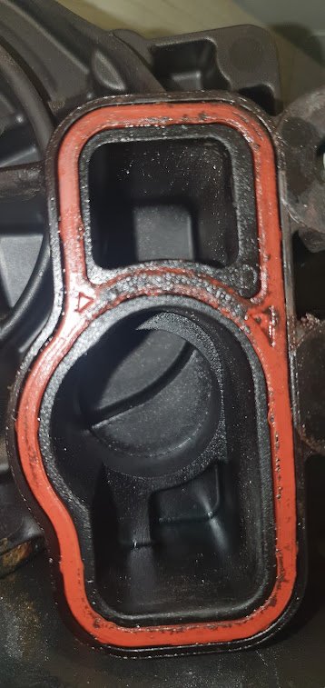

I check for leaks and could see the coolant orangey marks were under the water pump where it had been leaking slightly also there was slight play in the bearing and it was a bit grimy when spun but not too bad.
Ordered a new water pump and changed it. When looking at the water pump I could see the gasket had perished between the 2 chambers as shown in the photos.

The only thing I can think of is the gasket leak between the chambers was affecting the thermostat which was probably causing other problems too. Anyway, I think I could have gotten away with just changing the gasket with is about 10 quid on ebay.

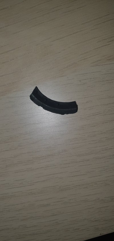

Anyway, I think I found out what it was (the thermostat). I pulled off the top hose and had a look inside the thermostat but all looked fine, but looking really close around the back I could see a little bit of rubber which was flapping around attached on one side which is part of the seal. Bought a new thermostat and fitted it and it's back to being good again! the gear changes are now smoothing out (most noticeably when warming up) and of course it gets up to temperature much quicker.
I guess that the rubber bit flapping around would randomly seal and other times not, causing strange warm ups and poor shifting/running. Also draining the coolent when changing the pump may have moved it causing it to seat properly for a while then eventually moving again.

Attached is the photos of the broken thermostat and the rubber bit that I eventually pulled off. If you look closely at the first pic you can see at the back the rubber is distorted. The second pic is that bit of rubber.
Here is the link to the gasket the old one I had wasn't in a good state.
