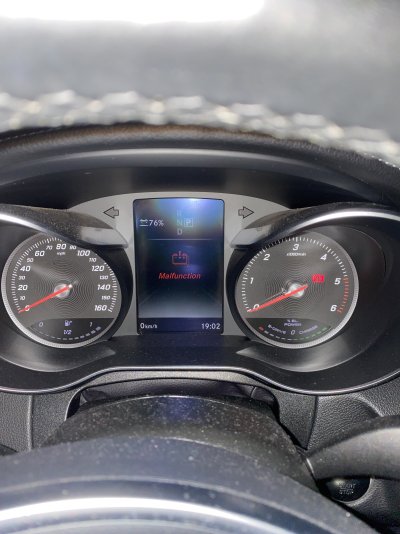

hi all, any one know what is mean? it just happen and I cant start engine :( all electric working fine malfunction.jpg
It looks like your battery is in a very low state of charge.
Disconnect battery.
Put battery on charger for sufficient time to achieve full charge.
Reconnect battery.
Start car.
If it doesn't start - Ask for more help.
Disconnect battery.
Reconnect battery.
Start car.
I just checked all battery and start/stop is ok, auxiliary ok just a problem is with HV hybrid battery, code of error is P1CA100 unfortunately this battery on MB is cost 13k£ which is joke because car is worth around 16k£ in my composition 🤣, sad is I can’t use car without battery just running on Diesel engine. I checked eBay for some replacement and I found around 1k£ used battery also I found few company how repair HV battery 🥺 but not many so think is, before u buy hybrid or electric car check cost of replacing battery first, never ever 👎
