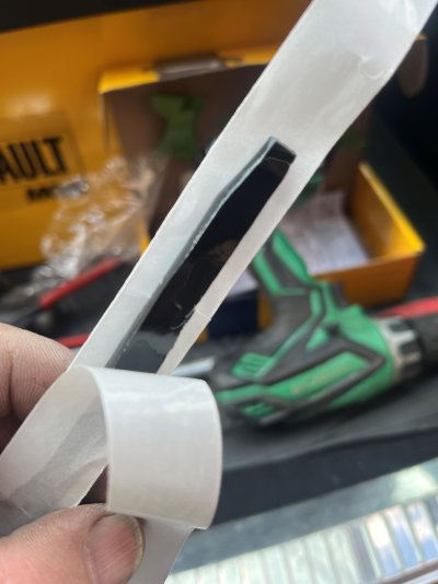

Fantastic, I’ll look for that video now. Many thanks Pete. 👍🏻 took the indicator lense out and the glass has come away from the body so Gona repair that and lubricate the rubber seal.
If you mean this rubber seal, then that doesn't seal the headlamp unit itself. It's a gasket that buffers between the bonnet and the headlamp, it just pushes into a channel on the headlamp casing.
Unfortunately the video mentioned above won't help here. R129 lenses aren't bonded, they clip on from the front so from your description it's either come unclipped or the hasp has broken with age. The gaskets are available as a replacement part - A1298260780 (I paid £15ea for mine but that was a while ago).
Hi Doodle, took the lens out and the glue holding the clear plastic from the body has perished. An easy fix and I’ve also treated the rubber to the ludicrously expensive merc rubber oil I use for the roof rubber on my money-pit of an R230.
