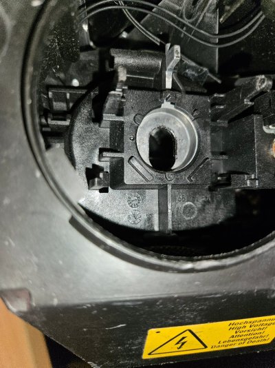

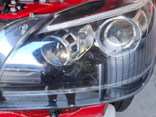

I have attached images of the RH and LH lights in-situ, and the xenon bulb holders, noting:
Any coding/compatibility issues between the Active Curve and ILS versions? The replacement light has the original ballast unit which I saved.
- The RH unit has a circular-type holder and a longer hole; and
- The LH unit has a square base and vertical prongs and a somewhat smaller hole but no holder.
